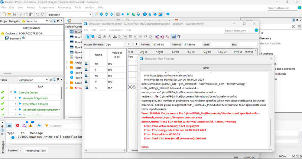

I am trying to put a project together and when I design my logic circuit and compile, it is successful. When I create a University WVF file, and try to do run simulation it give me an error that the file does not exist. Are there any solutions for this?

Hello, can you post the screenshot and copy the entire error message here.

I've found a solution. When you click "Run Functional Simulation" again, a window will prompt you to save the .vwf simulation file. Please use the default path and file name (do not modify it yourself) during the saving process, and this should resolve the error.
