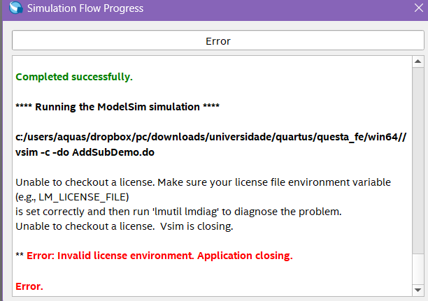

I am reaching out to seek assistance regarding a licensing issue I am encountering with Quartus Prime 22.1 Standard Edition on WIndows 11.
After setting up the license and configuring the environment variables, including adding the license file path to the environment variable and the License Setup in Quartus, I still receive an error when attempting to run a simulation (Error: Invalid license environment. Application closing.").

I have confirmed that the license path is correctly set in both the environment variables and the License Setup configuration in Quartus. However, the issue persists.
Could you please provide guidance on resolving this error, or let me know if there are additional steps required for the license to function properly?
