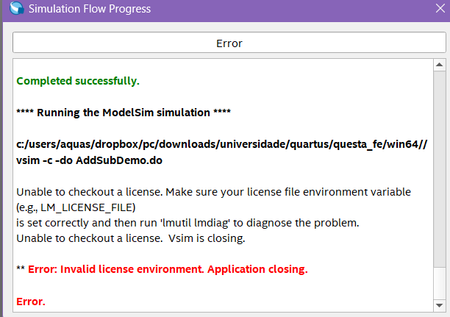

Please re-confirm your environment variable setup again? You need to set your LM_LICENSE_FILE environment variable to point to the license that Intel provides. c:\intel\license.dat or something similar.
You can refer to link on how to set environment variable.
To make this entry, you may perform a windows Search for "System Variables" and then click on "Edit the System Environment Variables" and then click "Environment Variables". Be aware that you must add the entry in System variables, not user variables.
https://www.intel.com/content/www/us/en/docs/programmable/683472/21-4/environment-variables.html
Specifying the License for the Questa
https://www.intel.com/content/www/us/en/docs/programmable/683472/21-4/specifying-the-license-for-the-software.html
We recommended to use the right OS for Quartus. You can check whether your machine is supported or not (OS) by referring to ling below:
https://www.intel.com/content/www/us/en/support/programmable/support-resources/design-software/os-support.html?wapkw=operating%20system%20support
Additionally, kindly used latest Flexlm version for this.
