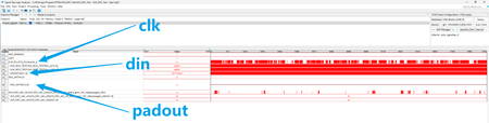

Hello everyone, I am planning to use the IP "GPIO intel FPGA IP" to realize Double Data Rate. When I use it, I make sure that the clock and input data for DDIO are correctly given. However, DDIO doe...
RichardT_altera
2 years agoI run your design and notice that your design is not timing clean. (with or without signal tap). You will need to close the timing first before run signal tap.
Have you try to run simulation to check the design function?
