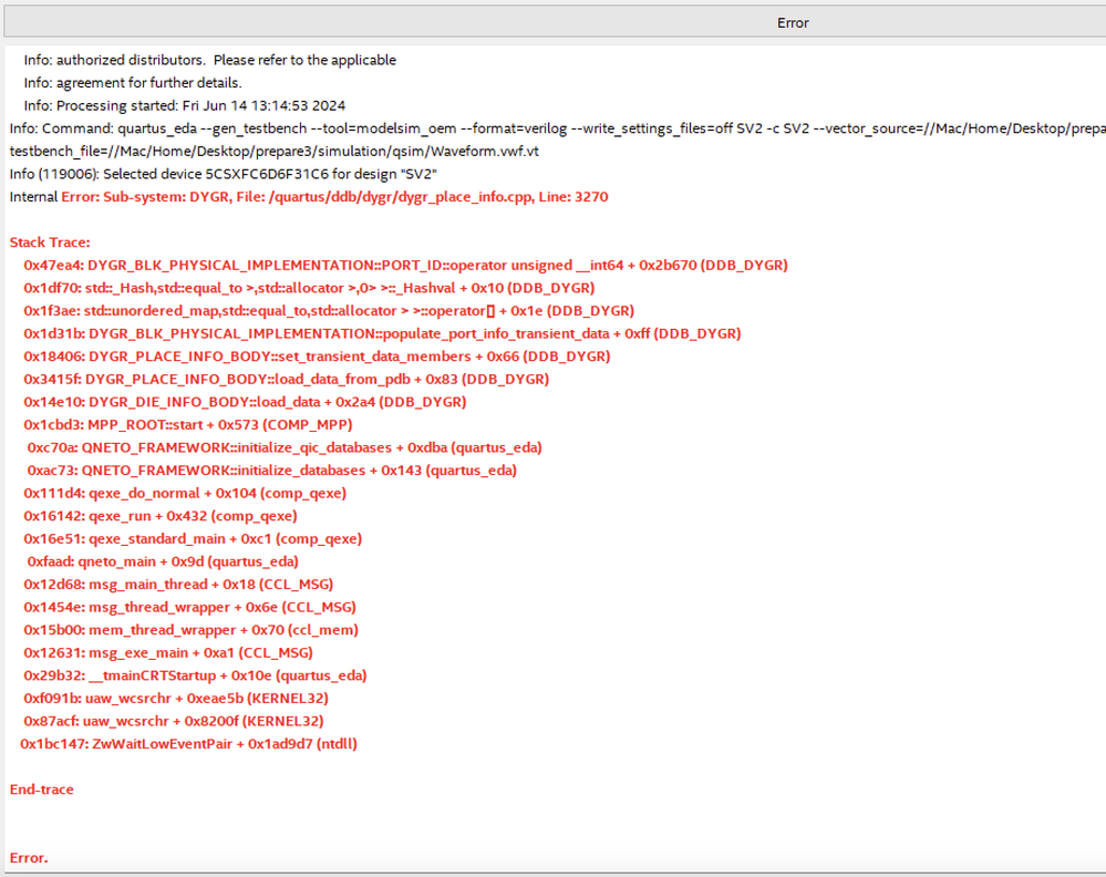

        i attached the error. im using quartus prime lite 17 and i have macbook air M1 , im using parallels 19 and win11 , im not sure i understood what megawizards is .
