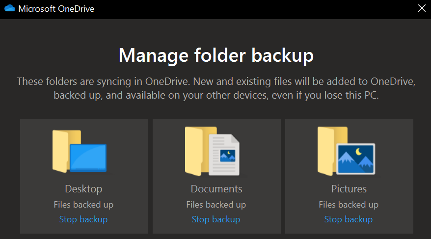

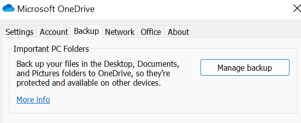

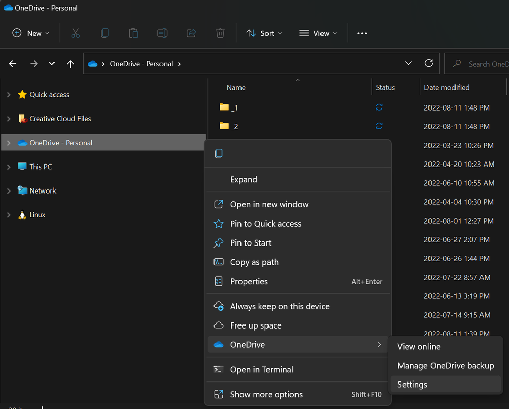

I confirmed this was my issue as well. For those not sure how to configure OneDrive for this:
1) From File Explorer, right click on OneDrive in the Navigation Pane (left side of window where My Computer is)
2) From context menu select OneDrive->Settings
3) Click on the Backup tab and then Manage backup button
4) Click the Stop backup link for Desktop and then click Stop Backup
5) Close the window, setting is now applied, Quartus should be good. This worked for me with version 21.1.

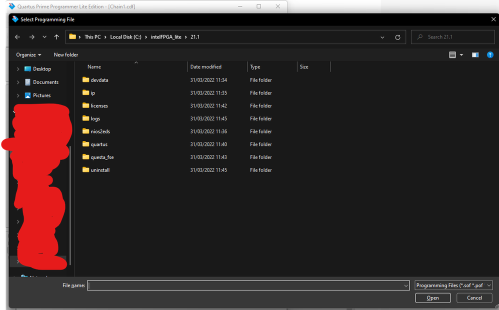

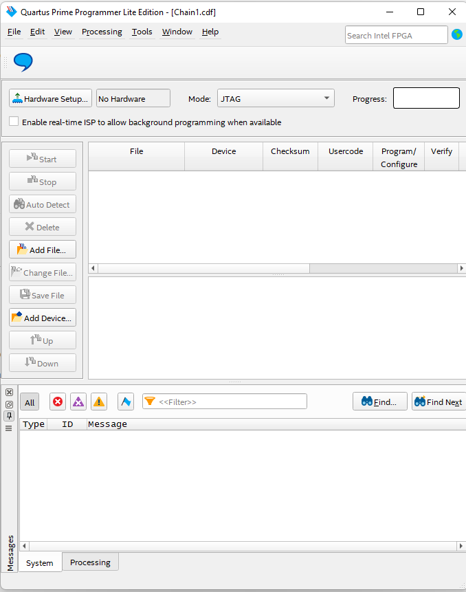

a screenshot of an example:
open programmer:
click on add file:
The browser prompt doesn't respond for about 2/3 seconds and then crashes the entire suite (programmer/quartus/...).
