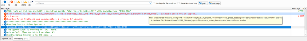

Quartus 23.4 often fail to compile
Hello everyone,
I often encounter the following error when compiling with Quartus.:
I can only keep trying to recompile, and sometimes I can succeed. May I ask what causes this? The software information is as follows:
PS: The path where my project is placed also has no write protection restrictions. The fpga device is cyclone10 gx.
Thanks a lot!
Eric

    I copied the project to the root directory of a hard disk, and the probability of this error was greatly reduced. It might be caused by the fact that the path of the previous project was placed too deep.

    I'd try reinstalling Quartus or try bringing your design files into a clean, new project.

      Thanks for your suggestion, I have reinstalled the Quartus, but it dose't work....

        I'd test compiling on a different computer if available. The error you're getting doesn't have a reference message number and it's not an internal error causing Quartus to crash so it is very strange.
        If it still fails even on a different computer, there is something in your design that the compiler does not like.

    Or try to clean project? Project -> Clean Project

    Hi Sheng, clean project failed as below photo:

    You're create revision based on other Quartus version, that's why the error appears. Please delete the revision and re-create the revision using current Quartus version.

    I notice the error message points to some path. May be try delete that path folder or check .qsf is that any assignment points to that path (if yes try to delete it)?
