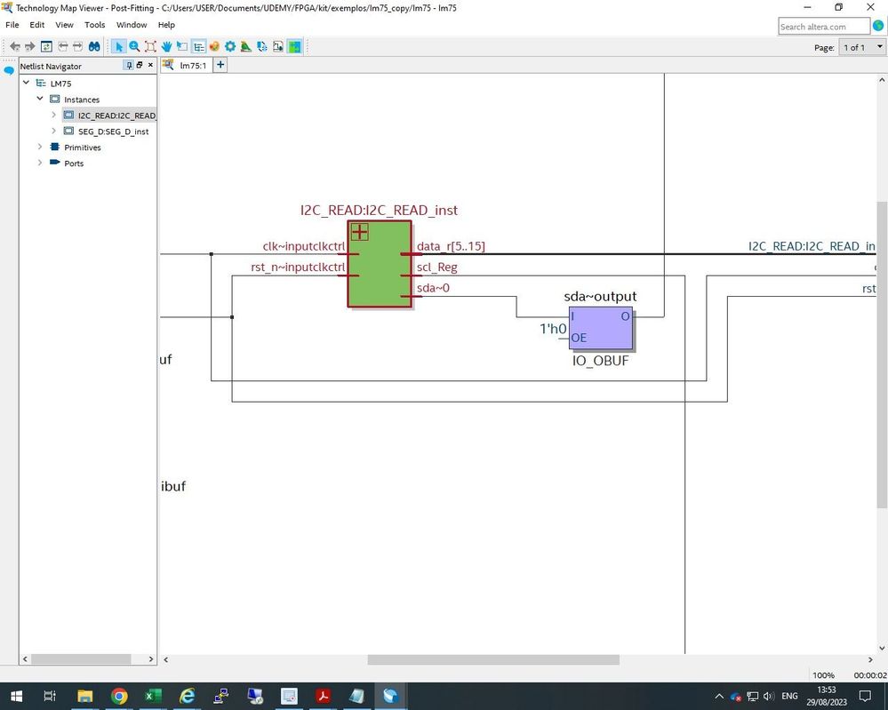

And generate the following hardware connections:
As the "sda" output must be tri state, in this conditions, the FPGA don't do the job as it should.

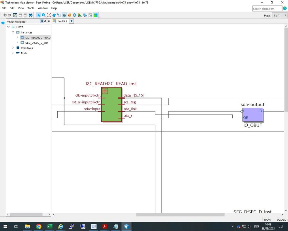

If I change the code lines to the following:
  sda <= sda_r when sda_link = '1' else 'Z'; --tmp_ivl_0;
The warning goes away and the connections generated are:
In this situation the FPGA acts like it should.

  • The extra signal in there does not synthesize to a tri-state I/O correctly. It depends on the device architecture, but assigning the Z directly like you do in the second example is required for Quartus to interpret it correctly, setting sda_link, in this case, as the OE.
