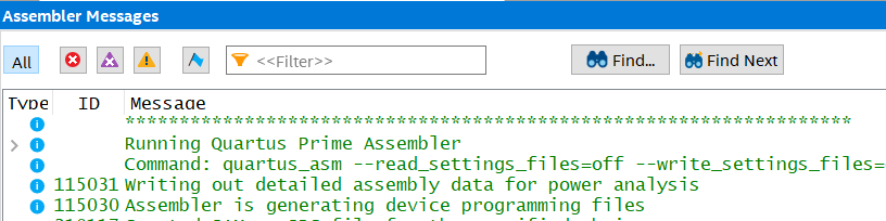

    what do you see in compilation report/assembler/messages?
    Should show something like
