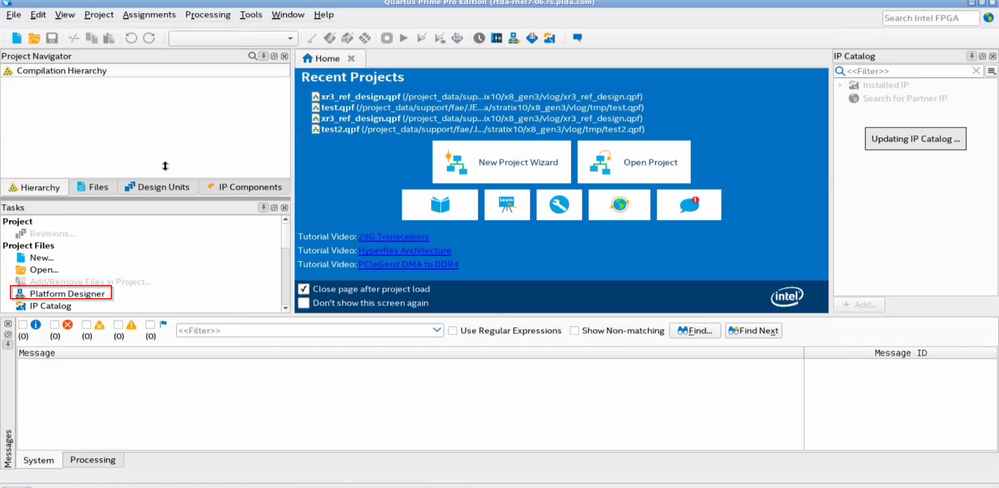

We recently installed Quartus prime Pro 20.1. When we want to open "Platform Designer", this latter is stuck during the splashcreen.
To reproduce the issue:
- we set the environment variable: "export QUARTUS_ROOTDIR_OVERRIDE=$INSTALL_$PATH_201"
- we launch Quartus: "${QUARTUS_ROOTDIR_OVERRIDE}/quartus/bin/quartus"
- we try to open "Platform Designer" (on "task" menu):
Thanks in advance,
Julien
