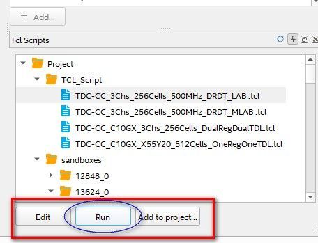

      You know, we can add many kinds of constrains into QSF file. I have many location constrains which are required for my logic nodes. Some are arranged by other enginners, some are created by me. So there are several options for this kind of constrains. Then this kinds of constrains are saved in different TCL files. When one of these options is tried, its TCL file will be run in Quartus TCL script window and the corresponding constrains will be added to project.
      Now, we encounter one problem for running TCL script file in Quartus Tcl scripts window. It will take long time after I click the "Run" button. Sometimes, it will give me one fatal error info after I wait for long time.
      I can copy all comments of the TCL file to QSF file to complete this constrain. But I want to fine one feasible way for us to arrange this task. For example, can QSF source our TCL file? Then we do not need to run it in Tcl script window, and also don't need to copy these comments from TCL file to QSF file.
      I know QSF file can source one kind of TCL file using below assignment:
      set_global_assignment -name POST_FLOW_SCRIPT_FILE "quartus_sh:JicGen.tcl"
      I use above assignment to complete JIC generation automatically during full compilation. So I request here whether there is similar way for QSF to source location constrains which are distributed into different tcl files? It means that the QSF file is the top-level, and other TCL files are the low-level.

    Yes, just use the source command in the .qsf file to point to the script.

      It seems that i met problem when i source tcl file in .qsf file. My constrains are stored in tcl script file TDC-CC_3Chs_256Cells_500MHz_DRDT_LAB.tcl. I put it in project directory, and source it in .qsf file as following.
      However, i got follwing blue colour info after i compile project. Quartus seems can't find my tcl script file, why?
  • sstrell's avatar
    sstrell
    Sourced Tcl scripts with assignments should be at the top of the .qsf and are read when you open the project. For some reason, the timing analyzer is trying to read this file. Check your timing analyzer settings.

      However, I have tried to change the tcl file to qsf, just changed the file's suffix(for example: from *.tcl to *.qsf), before i left office last Friday. Then I tried to source that new *.qsf file in my project QSF file. It ran well, I can implement what I want.
      Best Regard
      • MinzhiWang's avatar
        MinzhiWang
        Hello sstrell,
        I can source both TCL&QSF files in project .qsf now.
        For previous TCL file source issue, maybe, I made one simple rookie mistake. Becasue I accidently inserted space into the TCL file name:
        With space: * .tcl
        Without space: *.tcl
        So quartus will report several times in every compile stage for can't find *.tcl file. Actually, What I sourced is * .tcl file.
        Anyway, thank you very much.
