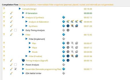

One question about Quartus Prime Pro's compilation dashboard
- 1 year ago
Sourced Tcl scripts with assignments should be at the top of the .qsf and are read when you open the project. For some reason, the timing analyzer is trying to read this file. Check your timing analyzer settings.
If you made any changes to the project settings or anything after compilation, they change to question marks.
Hello sstrell,
I know the case you mentioned. However, my case is not belong to your case. As I said that the question marks still appear just after full compilation.
The same project is normal when last compilation, however, it was marked with "?" after I made some changes and re-compiled the project again.
I met this issue several times, It may disappear if I ignore it after several modification. But I don't know why i appear and why i disappear?
