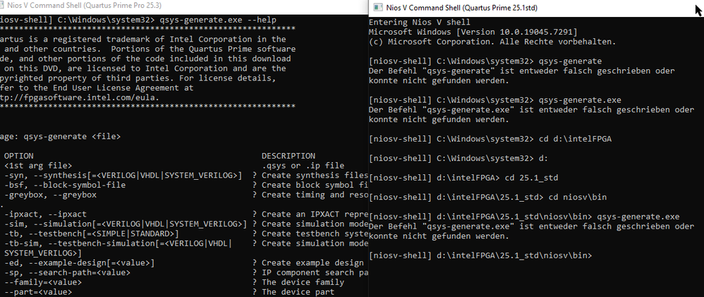

we are using makefiles to build our Quartus & QSYS projects. Since we switched from NIOS-II shell to NIOS-V shell, I realized that qsys-generate is no longer accesible.
The command "qsys-generate.exe" is either misspelled or was not found.
Other quartus commandline tools remain available in NIOS-V Shell:
  • quartus_sh/quartus_sh.exe
  • quartus_fit/quartus_fit.exe
The command qsys-generate.exe does exist, it is simple not added to the path in NIOS-V shell.
What is the correct way to invoke qsys-generate.exe from within NIOS-V shell?

    Ah, sorry should have mentioned the version. Im using Quartus 25.1 Standard
    With the Quartus Pro versions 25.x the qsys-generate.exe is in the path of the nios-V shell.

      • FabianL's avatar
        FabianL
        Thanks, that solved the issue.
        Would be good, if the Quartus standard version would also have set the complete paths setup as the Pro version. IMHO there is no reason to have different setups for Standard & Pro

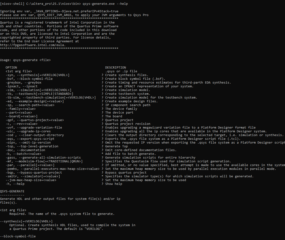

  • ShengN_altera's avatar
    ShengN_altera
    I try to execute the command qsys-generate.exe in niosv-shell without problem check:
