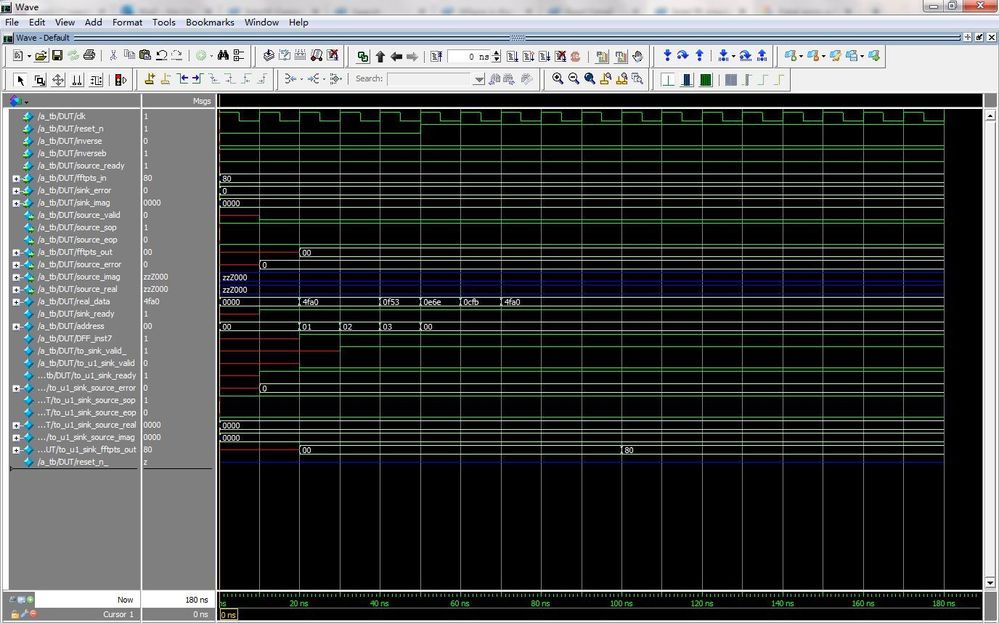

5,check the waveform, I can see the many signals are working as I expected, but suddenly stop in below stage
The error part is not my design, and it seems the low level library being called by upper design, I have no idea how to to fix them.

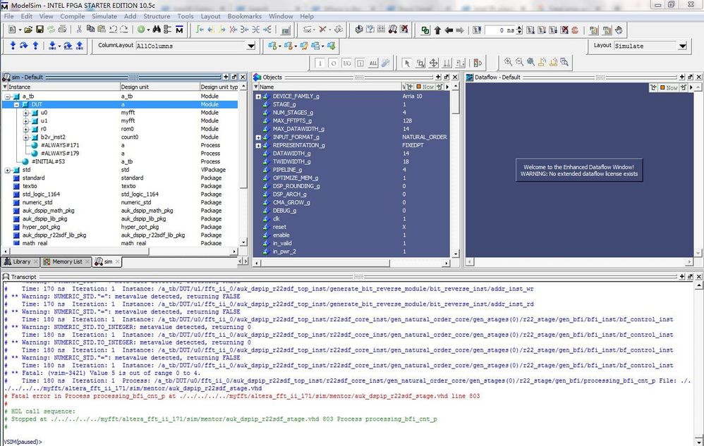

# ** Warning: NUMERIC_STD."=": metavalue detected, returning FALSE
# Time: 180 ns Iteration: 1 Instance: /a_tb/DUT/u0/fft_ii_0/auk_dspip_r22sdf_top_inst/r22sdf_core_inst/gen_natural_order_core/gen_stages(0)/r22_stage/gen_bfi/bfi_inst/bf_control_inst
# ** Fatal: (vsim-3421) Value 5 is out of range 0 to 4.
# Time: 180 ns Iteration: 1 Process: /a_tb/DUT/u0/fft_ii_0/auk_dspip_r22sdf_top_inst/r22sdf_core_inst/gen_natural_order_core/gen_stages(0)/r22_stage/gen_bfi/processing_bfi_cnt_p File: ./../../../../myfft/altera_fft_ii_171/sim/mentor/auk_dspip_r22sdf_stage.vhd
# Fatal error in Process processing_bfi_cnt_p at ./../../../../myfft/altera_fft_ii_171/sim/mentor/auk_dspip_r22sdf_stage.vhd line 803
