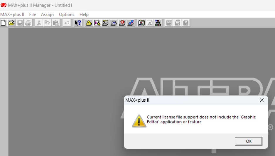

I have a license tied to a MAC card and I can't open or create a graphic project.
Has anyone had a similar problem and knows a solution?

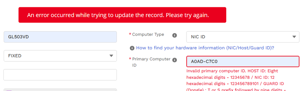

I am also trying to create a license for the HDD ID but the serial number (A0AD-C7C0) is not accepted, should be in should be in Eight hexadecimal digits format.
How can I get a license based on my HDD ID number?
R.
I can't help you with the MAX+PLUS stuff (why do you need to run ancient software instead of Quartus?), but for creating a license, you've selected a NIC ID (a MAC address tied to a network connection). As such, that has to be a 12 digit hex number. I've never heard of tying a license to a hard drive serial number.

- sstrell
