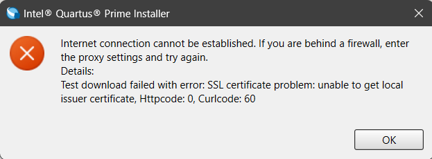

Im currently trying to download intel Quartus version 24.1 (recommended via the university), however im getting an error which ive added in the attachment below. I am on my home WiFi which is a private network and my laptop has no firewall or antivirus apart from windows defender active. Ive had this issue on multiple different internet connections and im wondering if anyone has any advice on how i can fix it.

- sstrell
https://community.altera.com/kb/knowledge-base/why-does-my-quartus%C2%AE-prime-installation-fail-with-certificate-error-ssl-certific/351512
- jergosh
I'm following the steps shown in the link you provided but i cant get it to work.
Any help would be appreciated
- RichardT_altera
Oh no, you need to use the file name for the installer.
Example:
qinst-standard-windows-24.1std-1077.exe
In your case, it should be:
qinst-standard-windows-24.1std-1077.exe -sp"--cacert C:\cacert\caert.pem"
You get the filename when you download it. Alternatively, the filename is also stated in the Quartus Download Center.
https://www.altera.com/downloads/fpga-development-tools/quartus-prime-standard-edition-design-software-version-24-1-windows
As a reference, this is another forum thread with the same issue:Regards,
Richard Tan
- RichardT_altera
Thank you, sstrell, for the response. This is a known issue.
Please refer to the Knowledge Article linked provided by sstrell and follow the resolution.
Richard Tan - RichardT_altera
As this is a known issue, we will continue to monitor this post for the next 5 days. If there are no further inquiries during this period, I will step back and allow the community to assist with any future follow-up questions.
Richard Tan - sstrell
You're missing quotes at the end. And you need to be in the directory where the .exe is located.
