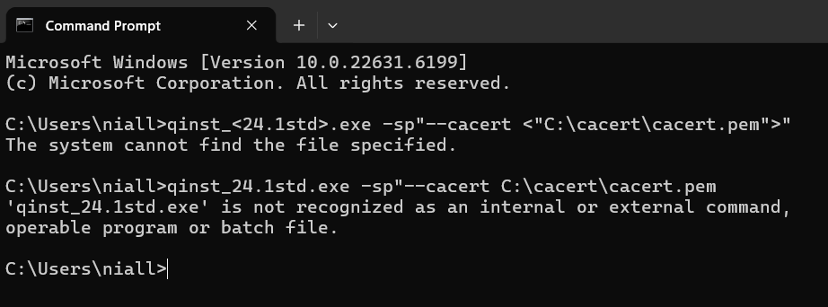

I'm following the steps shown in the link you provided but i cant get it to work.
Any help would be appreciated

Oh no, you need to use the file name for the installer.
Example:
qinst-standard-windows-24.1std-1077.exe
In your case, it should be:
qinst-standard-windows-24.1std-1077.exe -sp"--cacert C:\cacert\caert.pem"
You get the filename when you download it. Alternatively, the filename is also stated in the Quartus Download Center.

Richard Tan- jergosh5 months ago
thank you for the fast response i will try this now
