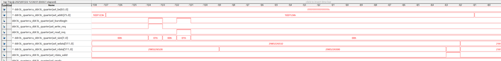

After changing the logic a bit and using the pre-synthesis signals to debug, I am able to get the behavior I expected:
I have attached the version of the code that worked as reference. The main difference is my state machine was waiting on a registered version of the the ready and read data valid signals (part of previous attempts at troubleshooting). Changing the valid read condition to just the original read data valid signal seems to have solved the issue. Attaching my code for future reference.
