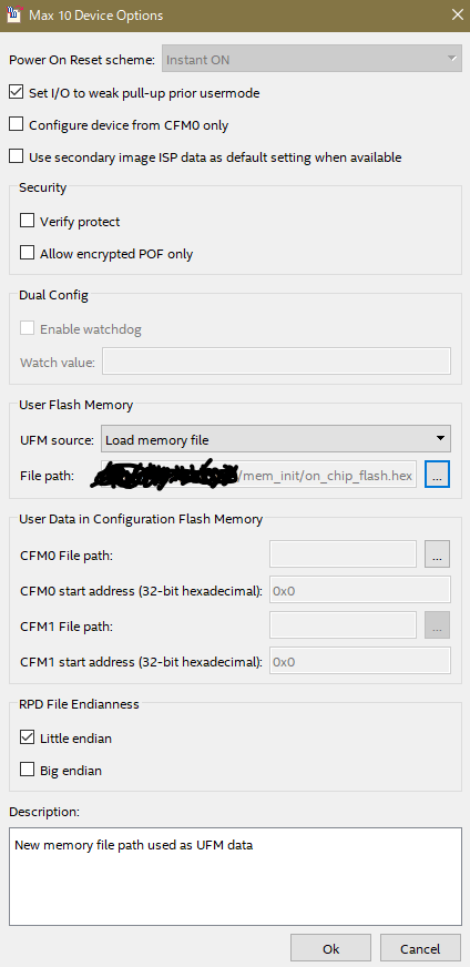

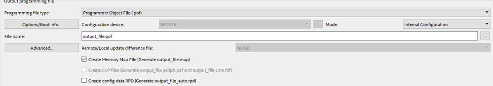

I want to initialize the on-chip flash using POF. However, when I try to make one from Convert Programmer File tool using the configuration as seen on the attached images, a "no input file" error pops out when I click generate.
I also noticed that after I closed Options/Boot info, a <top>.sof does not appear on the input file box, and neither manually uploading a SOF file works. Is it because the tool does not process time-limited files?

    Here is what i did.
    I am using a Max10 Evaluation Board for this.,
    -Using Quartus Prime Lite, I created a project and under it I designed a qsys file using a Nios2 Processor, an On-chip Flash Memory, a JTAG UART, and some other peripherals, set their parameters and wired them accordingly.
    -created a brd file to interface the qsys symbol to i/o pins
    -compiled the project, which didn't have critical errors albeit with timing warnings. This is where the time limited sof file get produced, i think.
    -assigned these pins to actual physical pins for clock and reset
    -after these, using nios2 SBT for eclipse, i generated the BSP configurations and built the project
    -then i also built the mem_init_generate files for the memory initialization hex files.
    -then, in quartus prime lite, i ran the Convert Programmer file tools, and configured the tool as described earlier.
    as for attaching the sof file, i tried to attach it by using the add file button which was the only button enabled.
    i attached it but nothing got attached.
    after seeing the link about time limited sof, i guess, it won't get attached. however, i dont have a non-time limited sof to check otherwise.
