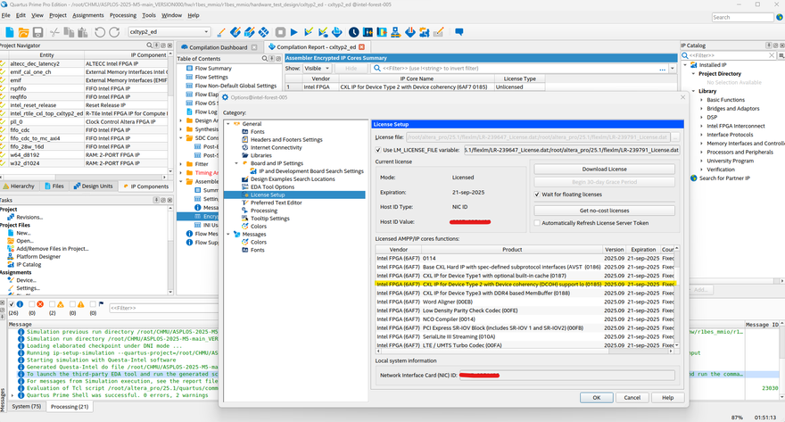

      I have another question regarding the Assembler (Generate programming files) step in the Compilation Flow in Quartus Prime Pro 25.1 with the target device set as AGIB027R29A1E2VR3.
      After configuring Quartus with the INI file, I tried to run the full compilation flow, during which an error occurs, saying Can not generate programming files for your current project because you do not have a valid license. Visit the Intel FPGA Self-Service Licensing Center at https://licensing.intel.com), with Message ID 23714 and no other details. Currently, my Quartus is configured using the trial license Quartus® Prime Software 90-Day Evaluation (Standard and Pro Editions) (License: EVALUATION-LIC), and other than Assembler, compilation seems to work fine. I initially suspected the lack of INI file for my device to be the root of the error, but as I'm seeing it again even after configuration, I'm not certain now.
      Can you help me troubleshoot this error? Is there something I can do on my end to fix the licensing issue?

  • sstrell's avatar
    sstrell
    Do you have any unlicensed IP in your design?
    • skim3's avatar
      skim3
      @RichardTanSY_Altera
      Under Assembler Encrypted IP Cores Summary from the Compilation Report, it seems that IP Core CXL IP for Device Type 2 with Device Coherency (6AF7 0185) is being recognized as unlicensed.
      Do you know why this might be happening, as when I look at Tools -> License Setup -> Licensed AMPP/IP cores functions, that particular IP appears to be licensed?
      I am also attaching a screenshot of my Quartus below:
  • RichardT_altera's avatar
    RichardT_altera
    The evaluation license for CXL does not support POF/SOF generation.
    You have two options:
    1.Use the Altera CXL IP Design Example (includes pre-generated SOF files for specific boards only; note: no changes to the IP or Design Example are allowed).
    2. Purchase the CXL IP license.
