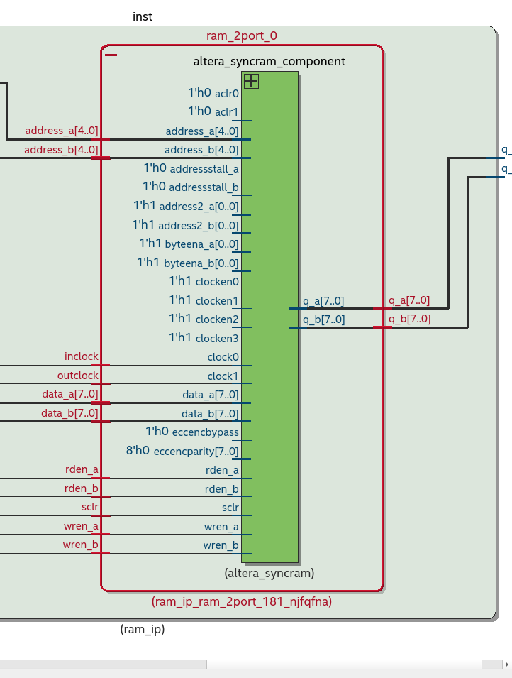

    (1) By using ip editor, we can see the "sclr" signal can be enabled by checking the corresponding setting in ip editor, and the external control is connected to the slcr pin of RAM:
    The following is the VHDL code with sclr signal, which is modified based on the template from Quartus prime pro:

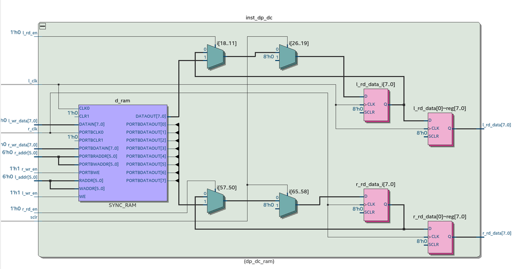

    The rtl circuit is:
    Comparing the two rtl circuits, you can the sclr doesn't connect the sclr pin of ram in the later one. And the same situation happens to the DFF as well. Is there anything wrong from my code, or should there be any parameters to enable the sclr of ram?
