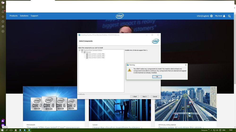

I can't install devices arria10 (all part). Why?
I did install quartus prime 18.0SE. Load devices "Arria10". When I launch Device Installer, in the “select components” window, after clicking next, a message appears: you didn't select any component for install. What should I do?

    So it doesn't work even after pointing the device installer to the location of the .qdz files? Weird. I'd try downloading them again, double-checking to make sure they are the correct version of the files for the version of Quartus you've installed.

        If they’re grayed out like that, it means the device is already installed. Are you saying that when you create a new project or try to select an A10 device for an existing project that Quartus tells you the device is not installed? If so, I’d just uninstall Quartus and start over.

  • Hi, it seems to me that the Arria 10 device has been installed. Do you see any further issues after Quartus re-installation?

    Thank you. I reinstalled Quartus and components. It work.
