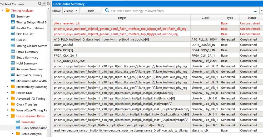

both the logic and the HPS work well but there are unconstrained paths reported after full complilation as below image shows.
I checked the 3 clocks with red highlighted, the 1st is JTAG clock and the 2nd and 3 rd are both introduced by the GSGI IP.
so my question:
I have thought for these clocks the tool will add constraints automaticlly as the EMIF IP do, but it seems not, how to add constraints for them?

You need to add the constraints for the Generic Serial Flash Interface Intel FPGA IP yourself. Here are relevant sites for you to refer:
https://www.intel.com/content/www/us/en/docs/programmable/683419/23-1-20-2-3/memory-operations.html

For JTAG related, i have just resolved it per below link, please focus on the rest two which related to the GSFI IP when you answer,
thank you.

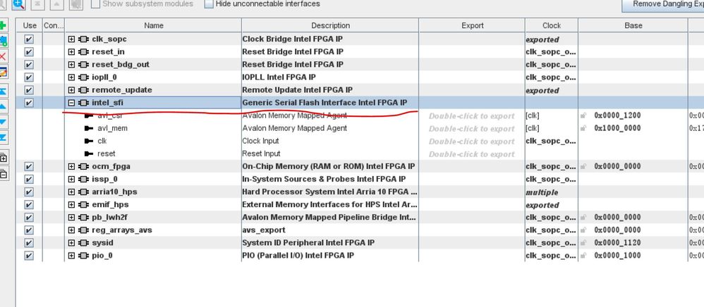

GSFI means "Generic serial flash interface", which is a control interface IP to the QSPI flash,provided by Intel.
I instantiated it in my design to access my QSPI flash, and i found the 2 paths which were reported unconstrained are related to this IP.
For clocks in the customized logic, i added the constraints by myself; for most IP such as DDR controller, the constraints are added automaticlly; but i don't know why this IP report this warning, shall the user add the constraints by themselves?
below attached is my HPS system and the GSFI is red highlighted.

thanks for your reply, it is resolved per the links you provided.
