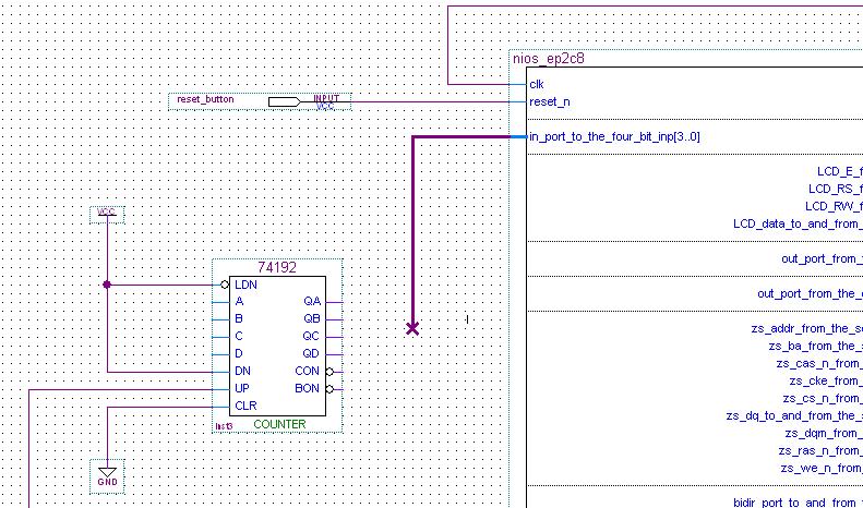

I am trying to split the bus from nios to interconnect with the 4bit counter but I cannot find the way. Is possible? please see the picture!

    Altera_Forum
    Hi Neos
    Name the counter bus something like counter[3..0] and then name each of the nodes (QA to QD) counter[3], counter[2], counter[1] and counter[0]
    Hope this helps
    Thiago

    Thank you for your reply!
    I wonder if this can be done?
    The counter is the IC component 74192.
    It is taken from the component library. If I double click it I can see the circuit logic... but I don't think that I can do something!

    If I understood the question correctly then do this:
    1) From the QA port draw a single line out that doesn't connect to anything and name it "counter[0]"
    2) Do the same with the QB, QC, and QD ports and name them counter[1], counter[2], and counter[3]
    3) Draw a bus line to the SOPC Builder system that doesn't connect to anything else and name it "counter[3..0]"
    Quartus II knows that those individual signals connect to the SOPC Builder system since they share the same name. Alternatively you could just wire the four outputs into a bus line within the counter and not have to worry about doing this in the schematic.

    It worked!
    Thank you very much both of you for the solution!!!
