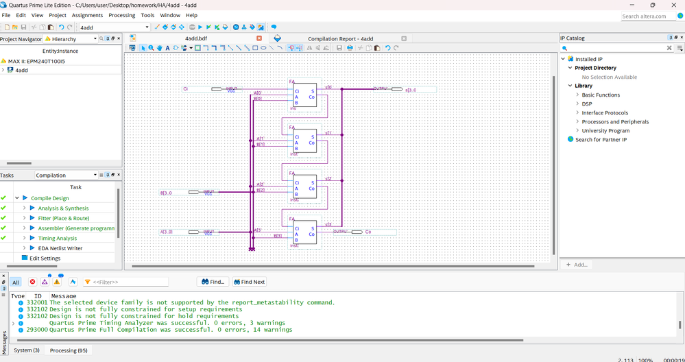

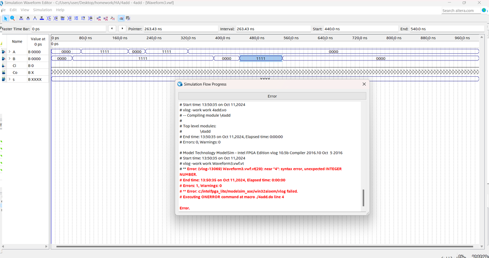

how can I solve this error?
# ** Error: (vlog-13069) Waveform3.vwf.vt(29): near "4": syntax error, unexpected INTEGER NUMBER.
# End time: 13:50:35 on Oct 11,2024, Elapsed time: 0:00:00
# Errors: 1, Warnings: 0
# ** Error: c:/intelfpga_lite/modelsim_ase/win32aloem/vlog failed.
# Executing ONERROR command at macro ./4add.do line 4
Error.

  • Try using devices such as Arria II GX, Arria II GZ, Cyclone IV E, Cyclone IV GX, MAX II, MAX V, and Stratix IV, then set the Target device to 'Auto device selected by the Fitter'. Afterward, recompile and recreate the .vwf file. In the Simulation Waveform Editor, navigate to Simulation > Simulation Settings, remove the '-novopt' option, and save the changes.
