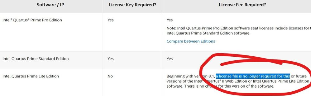

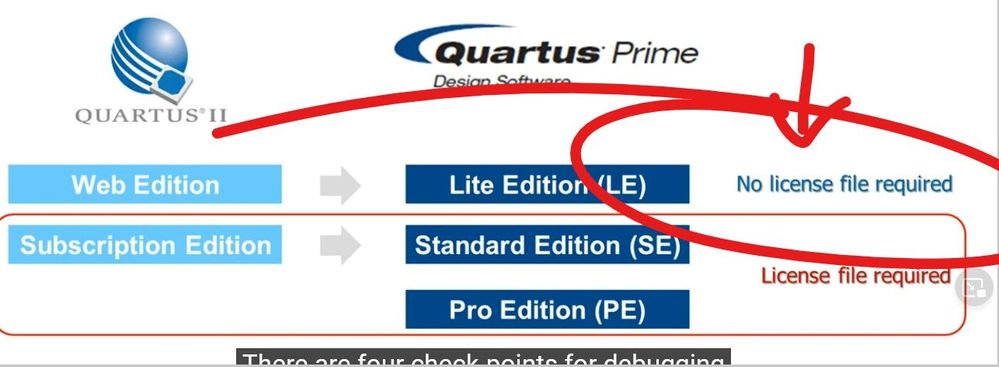

It occurred to me that you confused Starter Edition with Standard Edition, but I am not sure.
Please confirm whether this is the case or not.
We both here asked about Starter edition (Lite). In other words, we installed Quartus Lite.
In the video you posted, and in that place " Intel® FPGA Licensing Support Center" it says "No License file is required".
So why do we need to set up an env variable?
