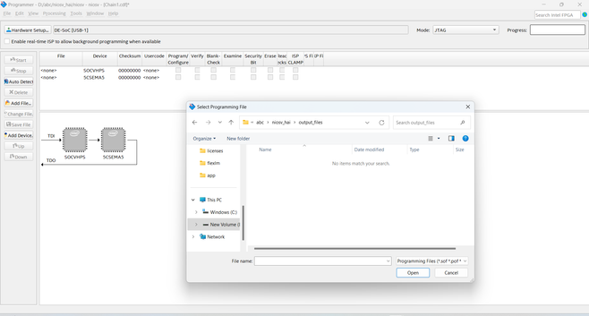

iam doing simple helloworld program using niosv processor in altera quartus prime std 22.1 version every thing is done but in output files folder .sof file is not generated i tried a lot of times but the file is not generated please give me suggestions why the file is not generated here iam using de1-soc board

No .sof indicates missing Nios V license, fitter messages should report the reason.
Review paragraph 1.3 "Licensing" in Nios V design handbook. You need to request a free license.

Can you check the fitter report messages, usually no .sof is related to the License of niosv.
If you got this type of error, you can solve it by requesting free license of niosV by referring to the chapter 1.3 on NiosV Embedded Processor Design handbook. You can refer it on the link below.
