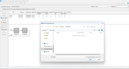

2 years agoFPGA ALTERA QUARTUS VERSION 22.1 with niosv-processor
respected sir iam doing simple helloworld program using niosv processor in altera quartus prime std 22.1 version every thing is done but in output files folder .sof file is not generated i tried a...

2 years agoHi Chandra,
Can you check the fitter report messages, usually no .sof is related to the License of niosv.
If you got this type of error, you can solve it by requesting free license of niosV by referring to the chapter 1.3 on NiosV Embedded Processor Design handbook. You can refer it on the link below.
https://www.intel.com/content/www/us/en/docs/programmable/726952/23-4/processor-licensing.html
