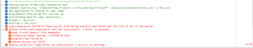

I have agilex 7 i series transceiver dev kit and i'm trying to using qsfp. There are example designs named bts_xcvr_nrz QSFDDD and bts_xcvr_pam4 QSFPDD0_1 that use qsfp. When i compiled the designs I am getting "Logic Generation failed to load results from Design Analysis and cannot get the list of IPs in the design". Also I'm adding here the error message;
When I compiled other example designs such as bts_xcvr_nrz SDI etc. there is not problem. It only occurs if it is QSFP.

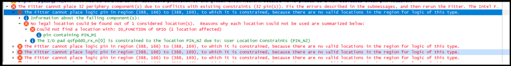

Also when I designed basic qsfp project without any IP, I can assign QSFP pins but during compilation this error occurs;
