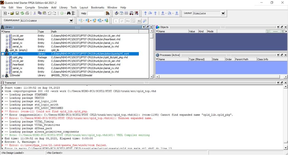

I am trying to do RTL simulation under Questa Intel Starter FPGA Edition-64 2021.2 & Quartus Prime V22.1 Build 917 Lite edition. Device is MAXII cpld.
But when run_msim_rtl_vhdl.do runs, vcom outputs Error:vcom-11 at top.vhd defined the library.
# ** Error: (vcom-11) Could not find cpld_lib.cpld_pkg.
Top.vhd describes the library define under the bellow. Quartus compilation is normal.
library cpld_lib;
use cpld_lib.cpld_pkg.all;
I defined the library using "Create a New library" already under Questa.
I attached Questa screen.
Could you support the solution for this error?

    Is that a space in your file path? Questa (and Modelsim before it) notoriously can't tolerate spaces in file paths.

      I cannot confirm space in the file path.
      Questa recognized the path as the bellow in .do.
      vcom -93 -work work {C:/Users/NIHO-PC3/SCST2/PTST CPLD/trunk/src/cpld_lib/cpld_pkg.vhd}
      I'm just trying to rebuild a project using Modelsim from 10 years ago........

    Can you change the file path to remove the space (even just make it "PTST_CPLD") and see if that works?

      Hello sstrell-san,
      Sorry, I understood about the mean of SPACE in the file path.
      I changed the path as your support and show .do as the bellow.
      vcom -93 -work work {C:/Users/NIHO-PC3/SCST2/PTST_CPLD/trunk/src/serial_tx.vhd}
      vcom -93 -work work {C:/Users/NIHO-PC3/SCST2/PTST_CPLD/trunk/src/serial_rx.vhd}
      vcom -93 -work work {C:/Users/NIHO-PC3/SCST2/PTST_CPLD/trunk/src/heartbeat.vhd}
      vcom -93 -work work {C:/Users/NIHO-PC3/SCST2/PTST_CPLD/trunk/src/crc16_ser.vhd}
      vcom -93 -work work {C:/Users/NIHO-PC3/SCST2/PTST_CPLD/trunk/src/cpld_lib/cpld_pkg.vhd}
      vcom -93 -work work {C:/Users/NIHO-PC3/SCST2/PTST_CPLD/trunk/src/cpld_top.vhd}
      After re-created a New library, although I executed .do, but error is same.
