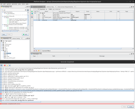

Error: spi_0: Failed to find module spi_spi_0

Are you trying to create just the IP to instantiate in your design or are you creating a Platform Designer system that includes this IP? If it's the former, you should be adding it to your Quartus project from the IP Catalog in Quartus itself, not in an empty Platform Designer system like you are showing here.
If you're trying to create a system design that includes the IP, I'm not sure if you're getting the error because the rest of the system is empty, which would be odd.
