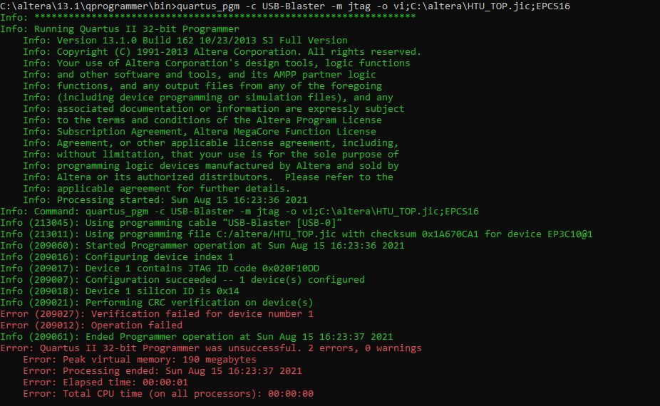

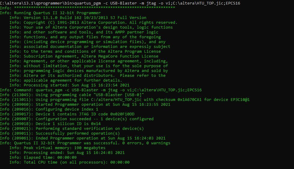

      i also try to erase the data and programming it again (same file of course). both, erase and programming was pass successfully and then i try again to do the verification check and its failed again.
      only when i unchecked the CRC check option, i pass successfully. it is the only solution i found till now.
      also, i run it on CMD. i try different type of verification command (according to user manual).
      i use : quartus_pgm -c USB-Blaster -m jtag -o vi;C:\altera\HTU_TOP.jic;EPCS16
      its failed(like at the picture i uploaded)
      when i try to change the "vi" command, it successes:
      V, CV : pass successfully
