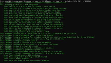

I have Error (209027) Verification failed when i try to run verify configure.
I succeed to pass the test after i unchecked the "check block CRCs or preform on-chip verification..." at option ...
