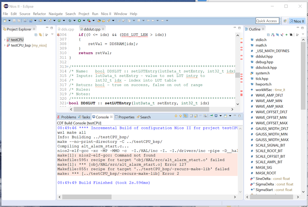

Eclipse problem nios2-elf-gcc command not found
I know there's an older very similar thread but the links to suggested solutions are now broken.
I've got myself a shiny new PC but I can't do any NIOS2 Eclipse work on it because I'm getting this problem, screenshot below.

  • Hi,
    What is the PC environment on your old PC vs the new PC?
    On another note, it seems to be the Nios II might be calling the "nios2-elf-gcc" instead of "nios2-elf-gcc.exe" for Windows.
    Could you try to open the nios II SBT/eclipse from Nios II command shell?
    In the Nios II command shell, run "eclipse-nios2.exe".

      Don't forget, it worked on my old PC. They are both Windows 10 Professional 64bit.

    I have tried generating the BSP from your sopcinfo that you shared and there was no issues.
    The environment that i am using is also the same as yours except for the Version of windows.
    I am using Windows 10 Enterprise 64 bits.
    Was able to generate it without any error seen.
    Just to make sure you have installed the plugins correctly :
    https://www.terasic.com.tw/wiki/Getting_Start_Install_Eclipse_IDE_into_Nios_EDS
    And also the WSL version is correct :
    https://www.intel.com/content/www/us/en/support/programmable/articles/000074066.html

      Right, so after a lot of searching on the web the problem was the wrong version of WSL. Windows really, really, really wants you to use WSL2 and I get the feeling from the MIcrosoft documentation updated in 2023 that the Intel documentation is no longer fully accurate on describing the process in sufficient detail.
      Sorted at last by the look of it.

    Yeah, the wsl version needed for the quartus project is version 1.
    Sometimes windows will switch the wsl versions but do double check if the wsl is version 1 else Quartus will have some issue.

    You could use the command below to check and list the distribution that you have installed and the wsl version:
    wsl -l -v
    Furthermore you could use the command below to set the distribution version:
    wsl --set-version <distro name> 1
