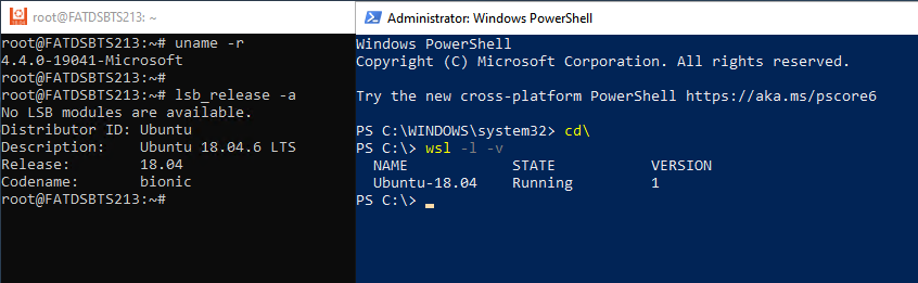

- AdzimZM_Altera
The WSL version and Ubuntu version look okay.
What is your OS build version?
Have you installed the distro packages for NIOS?
Can you provide the snapshot of the installation progress?
Last time I did encounter similar issue because the distro packages were not installed successfully.

OS build version is windows 10 10.0.19045

hi Adzim,
I install the distro package and Quartus Prime 22.1 is now working as expected.
