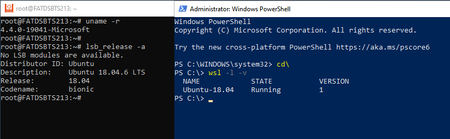

2 years agoddr3 SRAM Controller with Uniphy intel FPGA IP 22.1 failed
Hi Intel team, Please see below for the error message when i am generating the DDR3 IP. <html>Info: "<b>MyDDR3_master</b>" instantiated <b>altera_mem_if_ddr3_phy_core</b> "<b>p0</b>" <html>Info: "...

You can find the distro package on procedure 3 from this link: https://www.intel.com/content/www/us/en/docs/programmable/683525/21-3/installing-windows-subsystem-for-linux.html

2 years agoHello,
