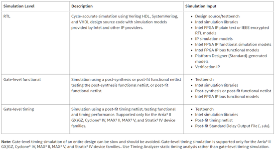

This is the information I found regarding this topic:
https://www.intel.com/content/www/us/en/docs/programmable/683080/18-1/simulation-levels.html
