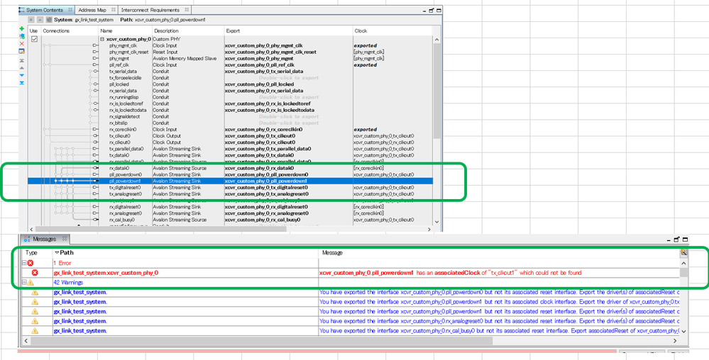

The following error is occurring on QSYS of Quartus Prime.
Could you please tell me how to avoid the error?
[composition]
QSYS implements CustomPHY (xcvr_custom_phy_0), Reconfig macro (alt_xcvr_reconfig_0), and reset controller (xcvr_reset_controller).
FPGA:Cyclone V GT(5CGTD5)
Quartus Prime version:17.0.0 Build 595
[Error content]
Synchronization Clock (tx_clkout1) for CustomPHY input signal pll_powerdown1 cannot be found.
[My opinion]
I think pll_powerdown1 does not need to be synchronized with tx_clkout1

    Every interface in a component, custom or otherwise, must be synchronous to a clock interface. I see tx_clkout0 in your screenshot, not tx_clkout1, so perhaps you did not create that clock interface.
    If you think it should not be synchronous to that clock (it's just asynchronous control signals), you could set it as a conduit interface instead of a streaming sink.
    I would like to change only pll_powerdown0/1 to conduit interface.
    If you know, could you please tell me?
    This is set on the Signals & Interfaces tab of the Component Editor. Right-click your custom component in the IP Catalog and select Edit to reopen the Component Editor.

      Maybe there is a misunderstanding.
      The error is not the IP that I created using the component editor, but the Custom PHY IP that was automatically generated using the IP catalog.
      Even in that case, can I change from "streaming sink" to "conduit interface"?
