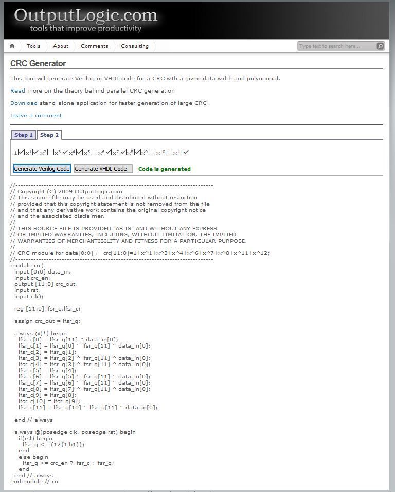

FYI just for fun I followed the instructions in the previous post for a CRC generator with a data width of 1, polynomial width of 12, with your requested polynomial, and it generated the following results:
- m_kumar
