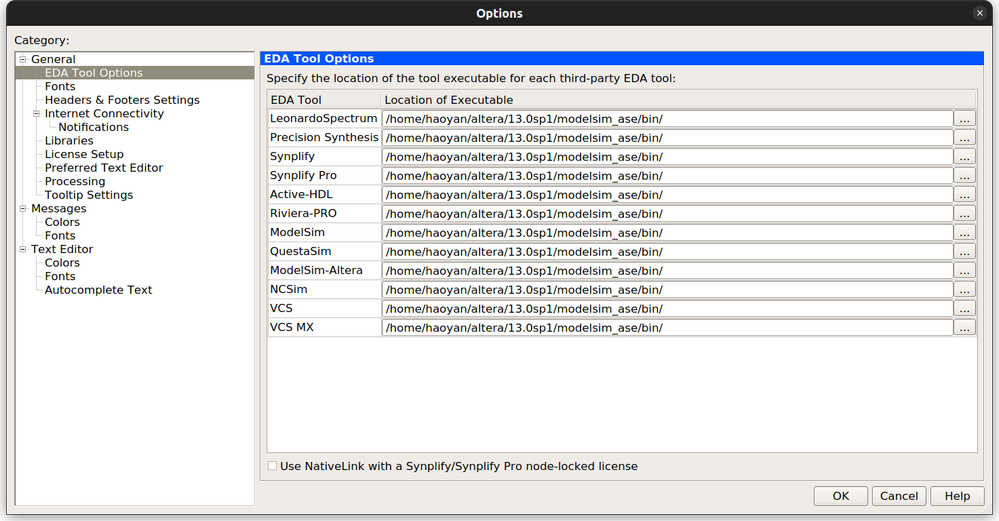

I can't run functional stimulation in Quartus 13.0 with Linux. Are there any solutions?

I don't think the path to the Modelsim executable is correct.
It should be something similar to .../.../<version>/modelsim_ase/linux32aloem
Please also check the OS is supported.
