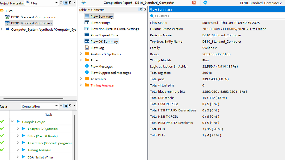

  • Hi,
    With the following steps:
    Go to Tools -> Platform Designer -> Load Computer_System.qsys -> Generate HDL (right-bottom) -> Recompile
    I'm able to compile with the Quartus Lite v20.1 check image below:
    File attached below for your reference. May extract and compile.
    Sheng

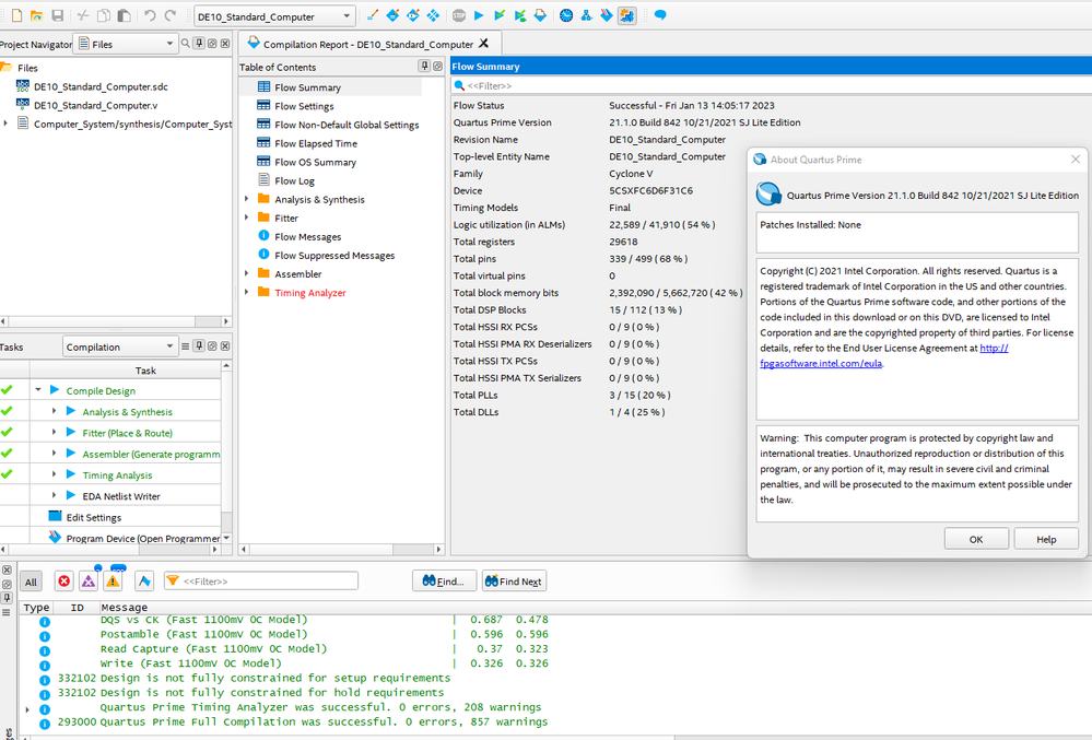

  • ShengN_altera's avatar
    ShengN_altera
    I guess you're downloading version 21.1 Monitor Program. It's recommended to use Quartus Lite version 21.1 and above. If not, probably there'll be some ip version mismatch issue like what you mentioned. If want to use version 20.1, have to regenerate HDL of the Computer_System.qsys and add in the newly generated .qip file.
    Btw, I'm able to compile the project with Quartus Lite v21.1 check image below:
    Sheng
    ShengN_altera
    Sheng
