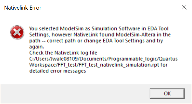

Can't launch Modelsim from Quartus
When attempting to Tools -> Run simulation tool -> RTL Simulation, I get this error

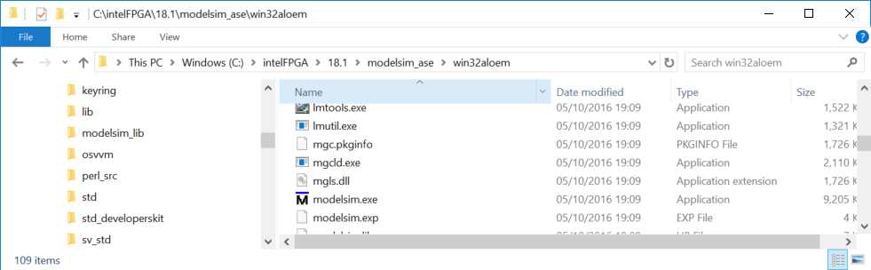

My EDA settings path is correct
I've appended an additional '\' as per this thread https://forums.intel.com/s/question/0D50P00003yyQA2SAM/cant-launch-the-modelsimaltera-software?language=en_US
I also have no spaces or brackets in the path.
I can launch Modelsim fine on its own.
the nativelink_simulation.rpt file is empty.
Any ideas?
Go to Assignments > setting > EDA Tool Settings > Simulation. Change the Tool name to Modelsim-Altera and it should work.

Fixed! Thank you very much :)
