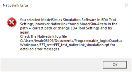

Can't launch Modelsim from Quartus
- 6 years ago
Go to Assignments > setting > EDA Tool Settings > Simulation. Change the Tool name to Modelsim-Altera and it should work.
Refer to the link below on how to use NativeLink Feature in Quartus Software:
https://www.intel.com/content/www/us/en/programmable/support/support-resources/design-examples/design-software/simulation/modelsim/exm-ncsim-native-link.html
p.s. Don’t forget to Reply, and Select the Best Solution. :)
- JWall406 years ago
Fixed! Thank you very much :)
