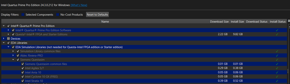

For 24.3, $QUARTUS_INSTALL_DIR/eda/sim_lib does not contain any verilog files. The unencrypted libraries seem to be available in $QUARTUS_INSTALL_DIR/../questa_fse/intel/verilog/src, but not cyclone10gx_atoms_ncrypt.v
Where are the encrypted simulation libraries stored in the installation for 24.3?

The "cyclone10gx_atoms_ncrypt.v" is located at (1) /quartus/eda/sim_lib/mentor or (2) quartus/eda/sim_lib/aldec.
Please check that you have the EDA simulation libraries installed for 24.3.

- gavin5342
Thank you very much Richard! I didn't notice that option. Now that I have ticked it, I have all the eda/sim_lib files.
