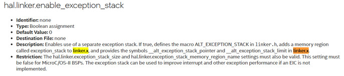

    For the linker exception , I saw there is some restriction mentioned at NiosV guide
    https://www.intel.com/content/www/us/en/docs/programmable/743810/22-4-22-4-0/bsp-settings-reference.html
    Just make sure to adhere to the restriction condition mentioned in the link above. Is there an issue or error that you're facing when migrating to Nios V design?
