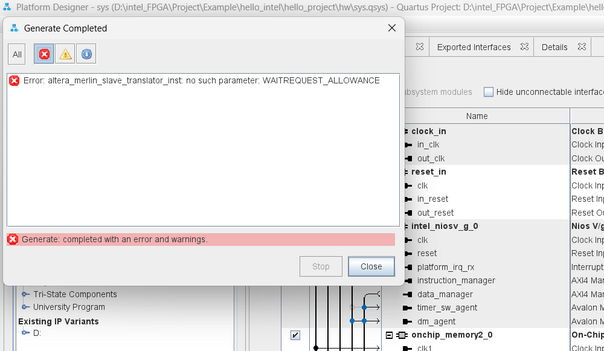

But it always shows an error message about WAITREQUEST_ALLOWANCE as below:
altera_merlin_slave_translator_inst: no such parameter: WAITREQUEST_ALLOWANCE

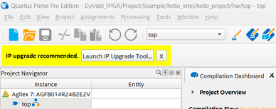

    2. Upgrade you IP tool. I saw from your photo there is a pop up suggested to upgrade IP.

    -Can you share the screenshot of the error message?

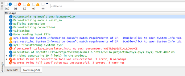

    • Eric_100's avatar
      Eric_100
      Hi
      Here are screenshots of the error message.
      How can I fix this error message?

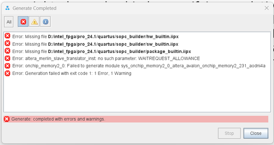

    • Eric_100's avatar
      Eric_100
      Hi Aiman,
      I run the design example on Quartus Pro version 24.1.
      I have updated all IP tools.
      I still get the same error message and other error messages.

    • Eric_100's avatar
      Eric_100
      Hi Aiman,
      After removing and reinstalling all Quartus related tools from my PC, it can now be compiled successfully.
      Thanks for your help.
