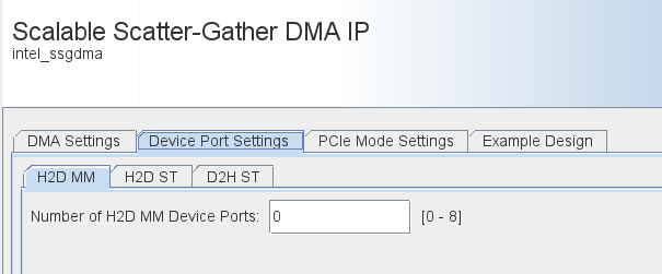

Could you check whether setting H2D MM to 0 allows you to generate the example design?
Please try this with the following configurations:
(1) Long Path Enabled
(2) Long Path Disabled
Do you observe whether the same issue occurs with (2), using H2D MM -> 0 , but the example design is generated successfully when (1) is enabled?
Richard Tan
Richard,
Here are the results from testing:
Long Paths Enabled, H2D MM = 0 -> Design example generation fails
Long Paths Enabled, H2D MM = 1 -> Design example generation fails
I was unable to disable long paths in the registry editor as I don't have permission to modify the registry. Would you suggest using Quartus in a Linux Virtual Machine to generate the design example?
