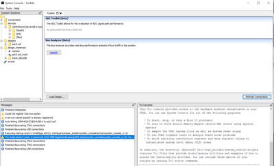

So I turned off the debug option when building a .bcf file to use less logic elements because I'm using the 10M04SAE144 chip. Does this mean I won't be able to run the ADC Toolkit in the Platform Designer?
It's saying no associated hardware. Here's a screenshot:

    Yes, disable Debug Path then not able to run the ADC Toolkit. Debug Path will implement high number of LEs. If wants to use that may be can use a larger board like 10M08 mentioned in video.
