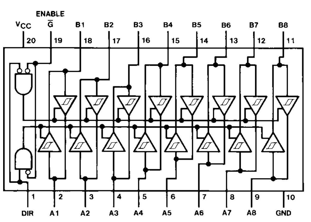

Hi all,
I'm doing some design using schematics block under Quartus 12.1 (as I' not not yet able to wrote HDL) and I was needing to drop on schematics a 74245 octal bus transceiver but I noticed it's missing in the library (also in the Maxplus2 directory).Is something I can find eslewhere or I have to build the symbol/design file myself?The logic diagram of the 74245 is well done in every manufacturer datasheet, I attach it here for reference.Thanks in advance for any help.

I made my own schematics .BDF design and .BSF symbol for the 74245, I attach them, perhaps someone can check if design has the correct logics.
- Deshi_Intel
I get a better idea what you are doing now. Basically you are trying to design a circuit function called "74245 octal transceiver" and connect to FPGA IO pins.
I feel unless someone in this forum community is familiar with "74245 octal transceiver" else it's hard for people to comment on your design correctness.
My suggestion to you is perhaps you can run functional simulation to test out your design functionality. This is a better and universal way to verify user design.
