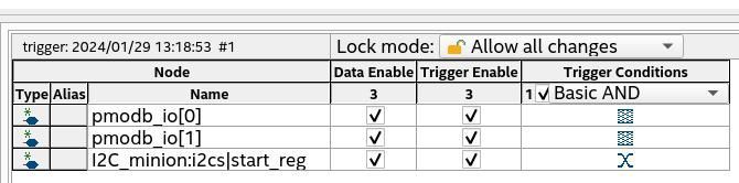

Start signal tap, change "Trigger Conditions" from "Basic And" to "Basic Or", it crashes:

    • andy25's avatar
      andy25
      No, I'm afraid this is not even close. Signal Tap.
      1) open quartus. probably dont even need a project. any project, doesn't matter.
      2) open Signal Tap: it looks like this. You dont need to add anything to the list.
      3) In setup tab, change "Basic And" to "Basic Or".
